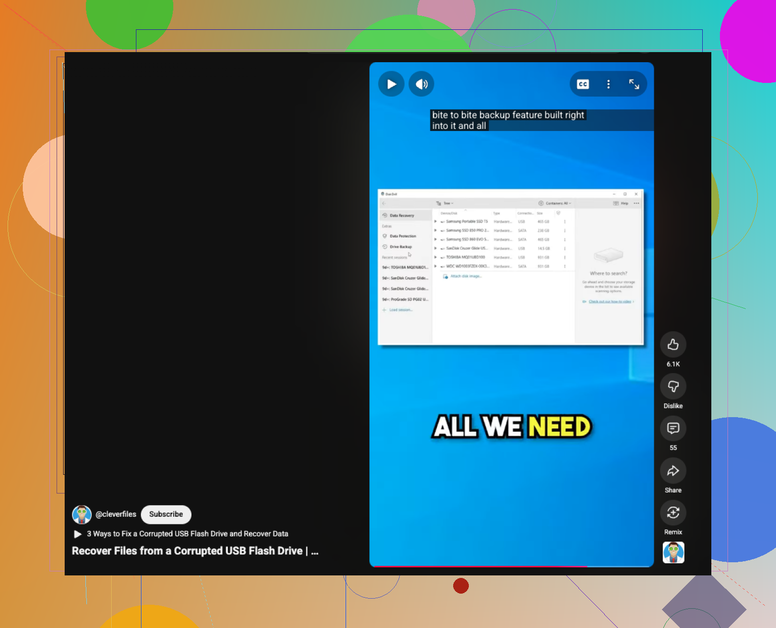

If the USB acts flaky, slow down
If it disconnects, stalls, or makes the system act weird, I’d make a byte-for-byte backup first and scan the image instead of the original stick. Less stress on the hardware. Sometimes one extra scan is all it takes to push a weak drive over the edge, so yeah, better safe here.
