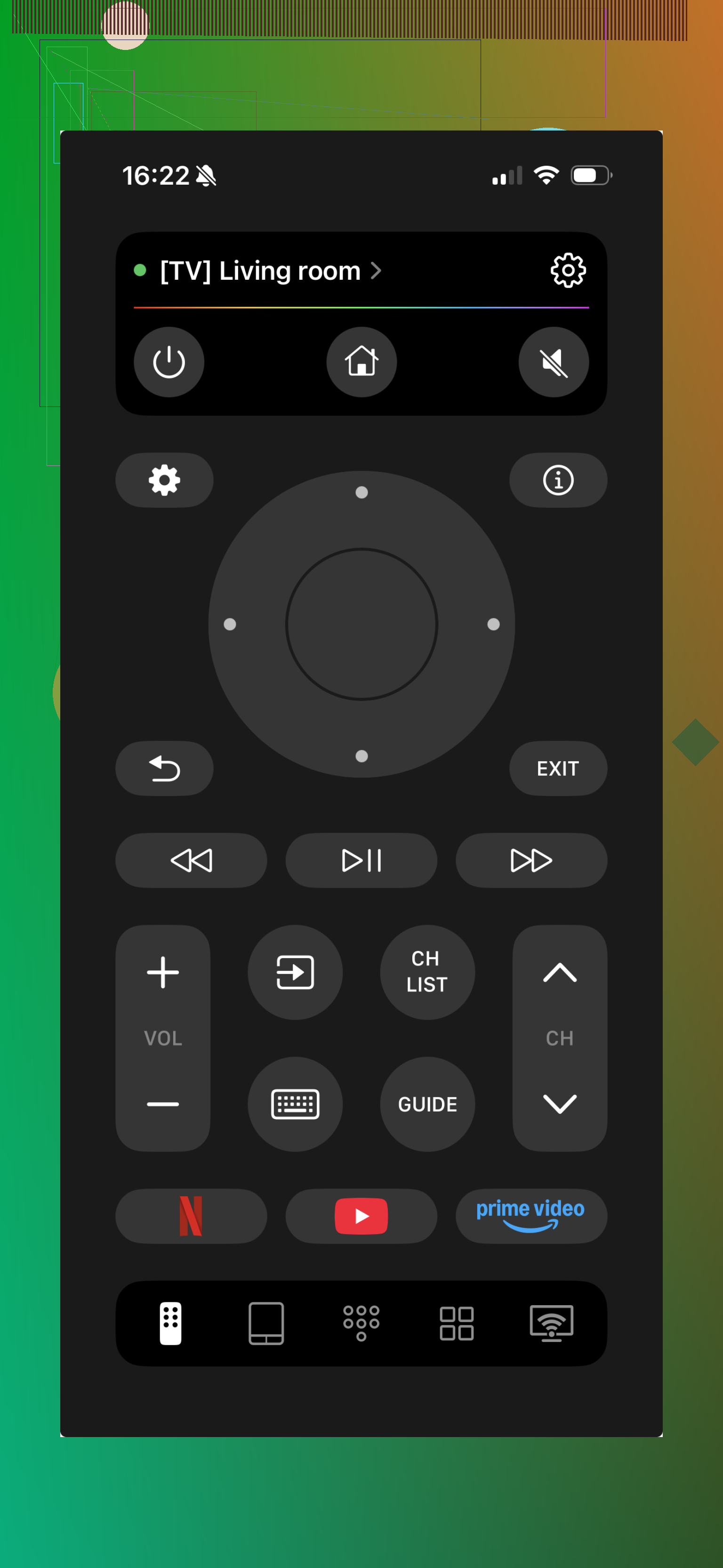

If the remote is useless, try your phone
I’ve done this when I didn’t feel like waiting around for staff. A phone-based remote app sometimes works if the TV is a smart model or connected to the same network.
One option worth trying is TVRem – Universal TV Remote App.
From what I saw, it works with a lot of smart TVs and streaming boxes, and it connects over Wi-Fi when your phone and the TV are on the same network.
What it helps with
It supports multiple TV brands.
You can change channels, raise or lower volume, and launch apps.
It helps when the physical remote is dead or missing.
Setup is usually quick, join the same Wi-Fi network as the TV and test detection.
