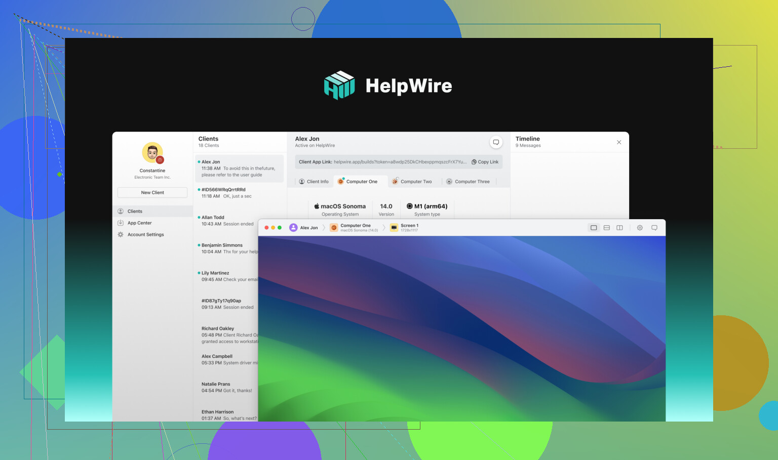

HelpWire: Simplified Remote Desktop for Various Needs
HelpWire is a refined, multi-platform solution aimed at IT professionals and casual users alike. Its compatibility with Linux Mint makes it a valuable tool.
When HelpWire Shines:
  1. Perfect for teams or individuals needing desktop access across Windows, macOS, and Linux.
  2. Speedy and dependable for the tech support staff working remotely.
  3. Simple enough for non-technical users to navigate.
Features to Love:
  • Access systems securely with just a browser link.
  • Remote file transfers made easy.
  • Built-in chat for seamless communication during active sessions.
  • Set up unattended access for consistent connection without manual oversight.
Advantages:
  • User-friendly interface requiring no steep learning curve.
  • Completely free!
  • Encrypted data ensures your privacy remains intact.
Drawbacks:
  • You’ll need an internet connection to use HelpWire.
  • Unfortunately, its functionality doesn’t extend to mobile devices yet.
