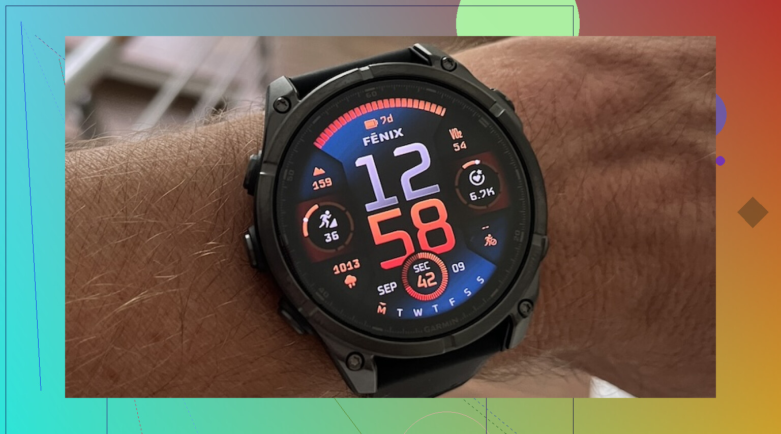

How Do I Connect My Garmin Fenix 8 to a Mac?
I’m trying to transfer some custom GPX tracks and audio files from my Mac over a USB connection. When I plug the watch in, it doesn’t mount as a regular external drive on macOS like older models used to.
I heard that people used to use Android File Transfer for this kind of thing, and that third-party apps like MacDroid might work too. How are you guys currently managing file transfers from a Fenix 8 to a Mac? Are there specific settings or apps that work best?
